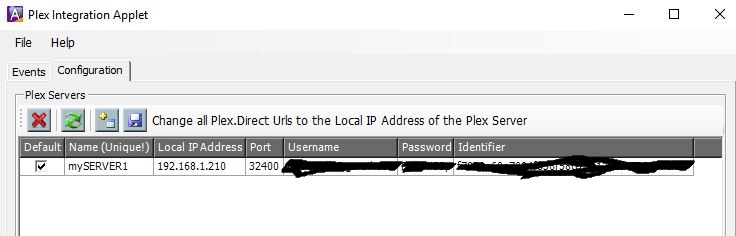

In the configuration tab visit the Plex Servers section. Click on the refresh button and your Plex server(s) should be automatically discovered. If you have more than one Plex server you need to designate one as the primary server.
The app assumes that Plex authentication is turned on. Please define your Plex users in the Plex Users section and mark one of them as the default user. All Plex queries against the server will be done using the default user's authentication.
It should look something like this:
PlexConfig
