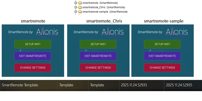

I have a couple remote projects:
1)  smartremote
2)  smartremote-sample
I have set the project name in the remote to each of them but same results.  Examining the about.html files in Designer both projects I only see the 3 buttons like  in the picture.   What am I supposed to get - more buttons to configure stuff?   Or more choices under "Change Settings?"
Thx, Chris
Edit:   I actually have 3 remote projects.  Below is a summary showing the about file in each one.  None of them have anything additional to the 3 basic buttons.   MyServer says my template is up to date.

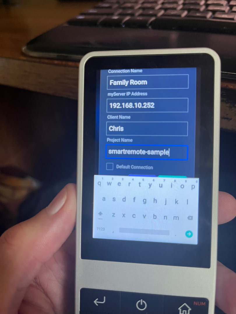

I downloaded latest Designer and did a project update to smartremote-sample.   I then directed the remote to smartremote-sample.   Hit the 3 dots and nothing there about backlighting.   I am on the latest smartremote template.
Here is a post from 5 months ago - "The latest SmartRemote template about.html file doesn't have the backlight options; somewhere along the line they got dropped and an old version of the file was included in the template."  Was this ever corrected?  The latest smartremote template in MyServer is well over a year old.
