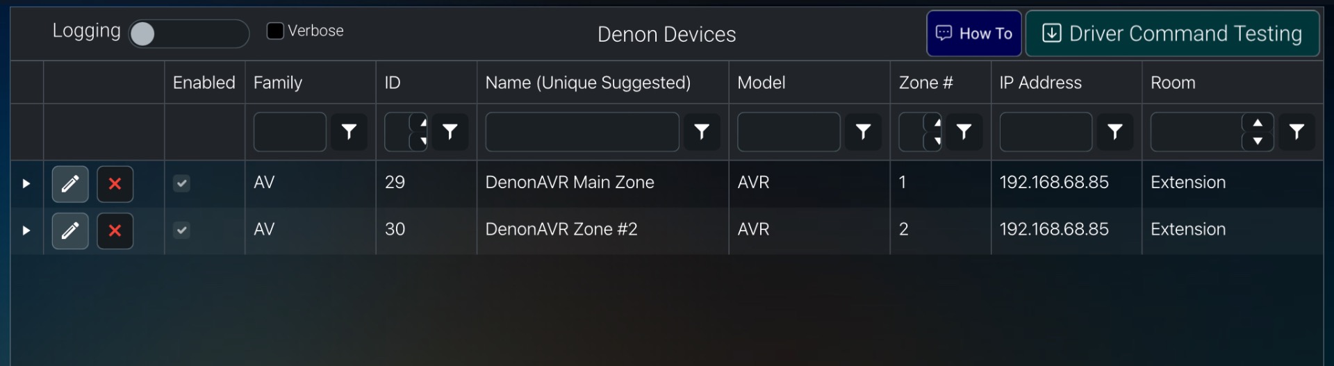

Nillaz - have you tried controllings zone 2 (or 3) with the Denon driver. I can't get it to work. If I send any command to it, the log reads
ERROR · Denon.doCommand - Error: No valid controller found for av|30~Power~On
Zone 2 is AV|30 - so I'm stumped...

Did you enable the zone? Zones other than 1 are not enabled by default so as not to consume device slots.

yes, I’ve ruled out anything obvious.  Zone is enabled, just not responding to commands.
