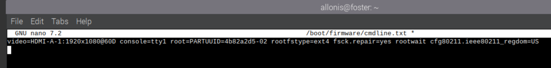

Hi, we are having difficulty teamviewing in...noticed you had VNC installed...not sure if that affects TV or not.
Can you carefully check if the "video=HDMI-A-1:"
mod was made to the sudo nano /boot/firmware/cmdline.txt
file?
reboot after you check and / or edit that file as per the instructions at the very bottom of that article.

I added this text to read:
Edit: Other drivers install successfully when I do a test install -for example the Marantz which i tried to install this morning. Only the Storm driver fails to install.
Also when I check the documentation only the Storm driver is NOT listed -all the other receiver IP drivers are listed.

nope made no changes.  please make the changes in my last post and reboot.

Ok strange.
I made the edit (see my prior post) rebooted and was able to log in and subsequently the system went offline and now is unreachable.
Regardless, I’m wondering if the Storm driver needed some tweaking because as I said before I was able to install other drivers successfully -all but the Storm driver.
It looks as if I will have to rebuild my system from scratch as it is unreachable.
