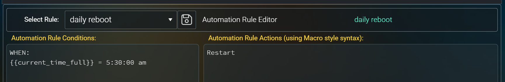

  1. The Harmony Hub periodically becomes disconnected from the server.  A reboot of the server seems to fix it.  My router is set to auto reboot at 5am daily, I wonder whether this daily router reboot is to blame - however have the Harmony set up with a static IP so I don't see why it should be a problem, but it does seem to be the primary culprit.  David - can you tell me how I create an Automation to reboot myserver at (say) 5.30am every day?

You shouldn't have to restart the server.
But the command to do that is simply "Restart" (how novel!)
You can set an automation event to trigger that at a particular time
Lets take a look at the Harmony driver again on your system. This week.

Thanks, this is all very much appreciated.  Screenshot attached for the automation - is this syntax correct?

Did you try to set the trigger for 1 minute from now and let it run to see if it works, then if so, reset to the time you want. I don't have syntax memorized like DaveP does :)

My syntax above was correct (I set it for one minute later and the server did indeed reboot). Thanks for that.
