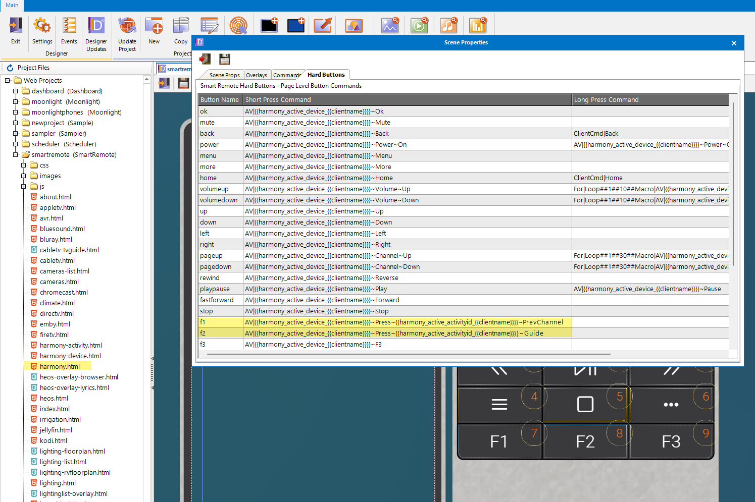

Thank you. I entered the commands. F1 brings up the SAP menu. F2 does nothing.
I am definitely a neophyte at this. Here is the screen shot. Where did I go wrong?
Hi Jim, I replied to this post a day or so ago (go back - post 1654)
allonis.com/forum/harmony-hub/43-how-goe...tions?start=162#1654
Hope my two cents / pence was useful.

Thanks. One last question. Which do I edit "harmony-activity", "harmony-device" or "harmony"
Like I said, I am a beginner.
You and me both!
I'm not sure what you mean - but if this helps...
in my example if I always wanted the F1 button to bring up the Guide, I would delete the entire contents of the short press command box for F1 and just replace it with:
AV|3~Press~80513405~Guide
Of course, the above would only work for me (because in my setup the Server has called the Harmony 'AV|3' and the specific code '80513405' is what the Harmony calls my cable TV box).  Yours will be different - hence the need to see what is happening in the logs to find the command you want to use.
